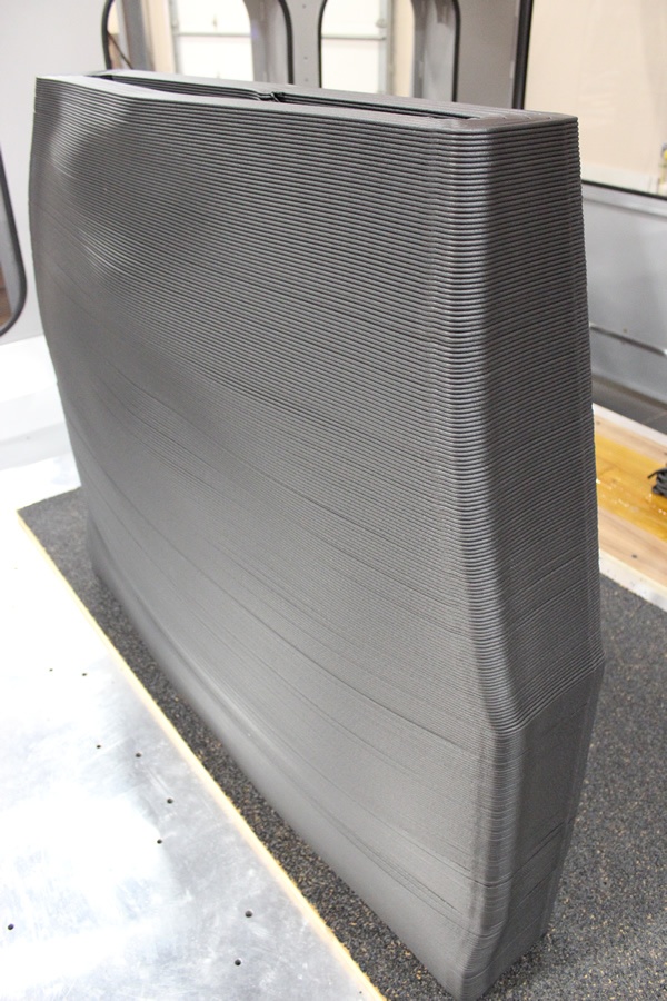

LSAM Solid Structure PrintingAt times, parts are printed as completely solid structures. When this occurs, bead length adds up quickly. A 5 foot by 5 foot solid layer requires 375 feet of bead length with a 0.800” bead width. Even with a 125 foot per minute print speed (which is the print speed of the PH50 at full output), it will require at least three minutes to print that layer. While this is still within a good layer to layer working time, it is clearly not overly fast.
Some parts which are printed vertically are so long that they must be printed in multiple sections which are then bonded together. With a fast enough print head and large enough table, all sections can be printed at one time rather than printing them one at a time. In this approach, you print a layer on one part, then move to the next and the next, until you have printed that layer on all the parts. Then, you return to the first part which should then be ready for another layer. You can also mix different types of parts and print them all at the same time, rather than one at a time.  With additive manufacturing technology today, this is the only way to speed up production rate. This approach makes fast print heads and large table sizes not only practical but quite desirable. Thermwood LSAM Tall Vertical Structure Printing

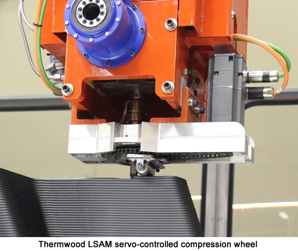

Once the bead has been applied, the PH Series print head uses a unique servo-controlled compression wheel to flatten and fuse each new print layer to previous layers. This wheel is the third servo in the PH series print head and can be instructed to automatically track machine motion.
Thermwood LSAM Servo-Controlled Compression Wheel
Since it tends to squeeze out any air that might otherwise be trapped between layers during printing, Thermwood has found that this compression wheel results in superior bonding between printed layers and a virtually void free printed structure.

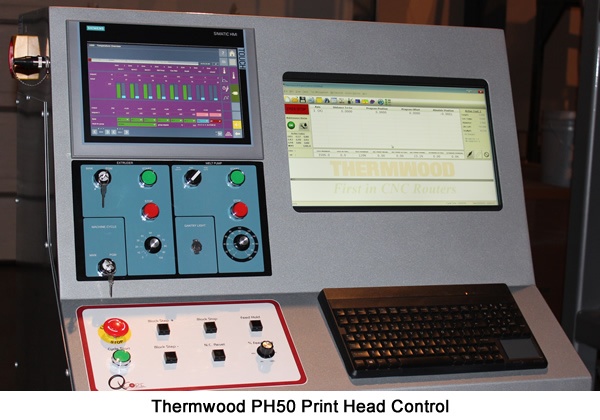

A unique aspect of this new print head design is that, unlike machine motion, the three servo drives in the print head are not machine axes. Thermwood’s print gantries have six servo drive systems, but only three of them are axes. A machine axis needs to be programmed. The servo drives in the print head have their own unique, independent, self-operating intelligent control functions, which they continuously perform without specific ongoing CNC program commands.
Thermwood LSAM PH50 Control
The CNC program simply tells them to perform their function and they do it without further specific instructions, even if those functions require them to interact with the machine program, machine motion or each other. For example, simply turn on the print function and move the machine and the print head will print the proper size bead as the machine moves, automatically adjusting for acceleration, deceleration and different machine speeds. Engage the compression wheel and it follows machine motion automatically. During printing, a delicate balance exists between the extruder and polymer pump in the print head. Achieving and maintaining this balance during all aspects of operation is also automatic.

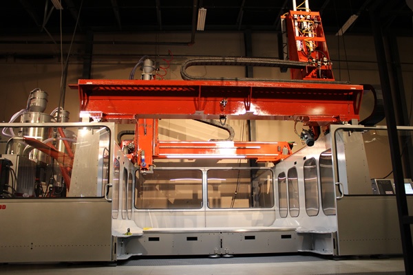

Thermwood Engineers Testing LSAM PH50 Head at Full OutputCurrently, the new PH50 print head has successfully operated at full output in a static position. Thermwood is replacing its 10x10 foot LSAM development machine with a 10'x20' foot demonstration machine to verify and demonstrate operation of this new head at full print speed. Thermwood believes that 10'x20' is as small a machine as is practical for this high output print head. LSAM machines are available with table lengths of up to 100 foot or more. Thermwood is confident that technology in the PH Series print heads could be used in even higher output print heads should a need ever develop.
